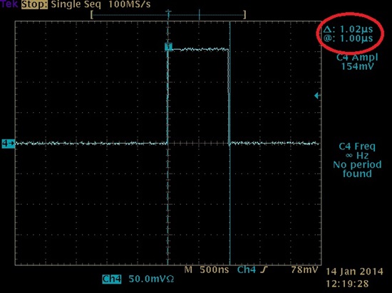

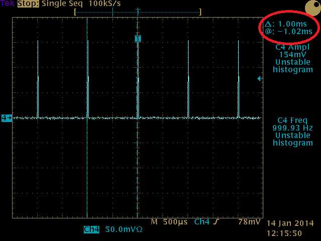

I am using the SN65LVELT23D chip to try change a pulsing LVPECL signal to a pulsing LVTTL signal. The arriving differential signal is an output from a comparator, where the signal changes between ~1.7 and 2.6V. (I am using both available differential pairs for the same purpose.
However, somehow from the output channels all I am getting is an AC waveform ~25 MHz, with the voltage oscillating between ~0.6 to 2.4V. This signal is on only when the comparator is pulsing (fully on 100% of the time, not pulsing along with the comparator output). No other pins have this sort of waveform on them, and the pulsing input only consists of 1 us pulses at a frequency of ~1000 Hz. Have I gone terribly wrong somewhere along the line and broken the chip, or am I doing something fundamentally wrong? Where is the 25 MHz signal coming from? This is happening when a 470 Ohm resistance is connected as the load for testing purposes.
