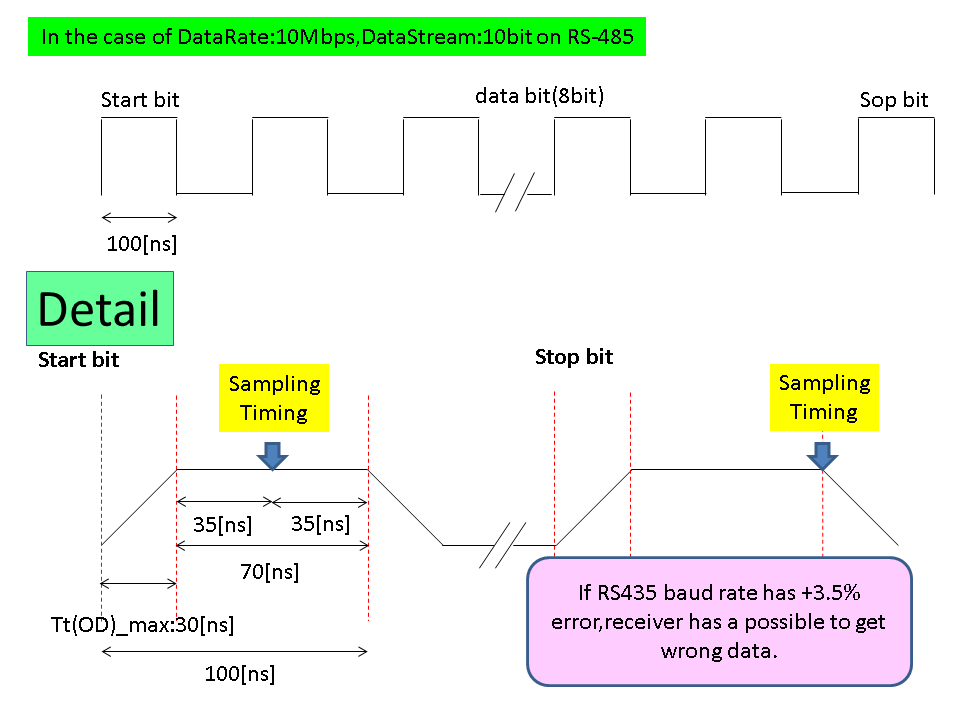

Hi,Mr.Ron
I'm sorry for my confusing questions.
I meaned , how mush pacentage is an allowance accident error of RS485 baud rate?
As a result of my research,I think that it is differ depending on bit size and method of micro computer .
Best Regards.
Taichi,
The RS485 signal is data only so the transmitter and receiver have separate clocks. Every time the data bit changes the receiver can synchronize its clock. In a 8 bit even parity data stream (worst case), sending a 0x00 will have 10 low bits in a row. At the end of the 10 bits, the receiver clock must still be accurate. With 10Mbps and 70nS of valid bit time, the clock must sample in this window of time. In other words the clock must be better than +/-3.5nS error over 100nS [+/-35nS/(100nS*10)]; This is 3.5% error.
