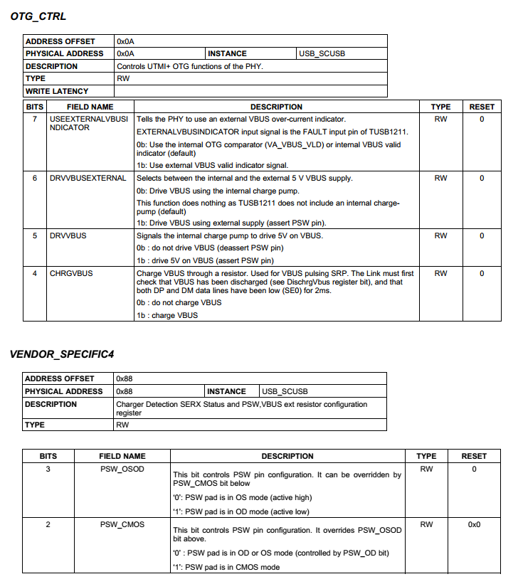

I need to control the PSW pin of the TUSB1211. The specification refers to a bit, PSW_OSOD, mentioned in table 2-1 of the spec. Where is it? There is no register map published with the specification. I am assuming it is a vendor specific register?
