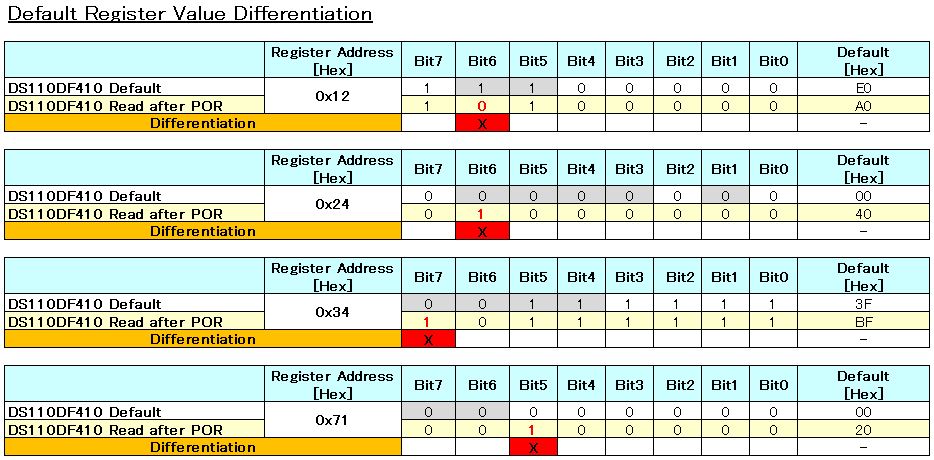

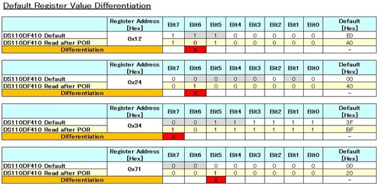

  • Hi Michael-san,
    Could you please let me ask about  the default register map which you had attached in the last post ?
    Our customer and I had read the register data of the device after POR(Power on Reset), but there were some differentiation.
    Could you tell us what these bits below means and whether there is any problem when they are changed to the default bit ?
    Address 0x12 bit6
    Address 0x24 bit6
    Address 0x34 bit7
    Address 0x71 bit5
    Kawai
  • Hi Kawai-San,
    These register are internal confidential state machine flags.
    Please note content of Register 0x02 which indicates the overall reclocker status. Would it be possible if you could please read register 0x02 CDR status register and explain what is the customer issue or problem.
    Regards,,nasser
  • Hi Kawai-san,
    The bits are read only and depending on the device status condition the bits are set by the digital state machine.
    Customer should ignore and not try to change these bits.
    Michael
  • Hi Nasser-san, Michael-san
    Thanks for your comments. I understood that thses four bits are all read only bits.
    In the case of writing this read only bit to the default value, would there be any problem ?
    For example, customer writes the default value for Register 0x24 bit6 = 0 when they use the EOM.
    I understand that it is best to ignore and not change these bits, but our customer had been already fixed their program and is difficult to change.
    As these bits are READ ONLY bit , I beleive that the change in these bits would not have an adverse impact to the device operation.
    Kawai
