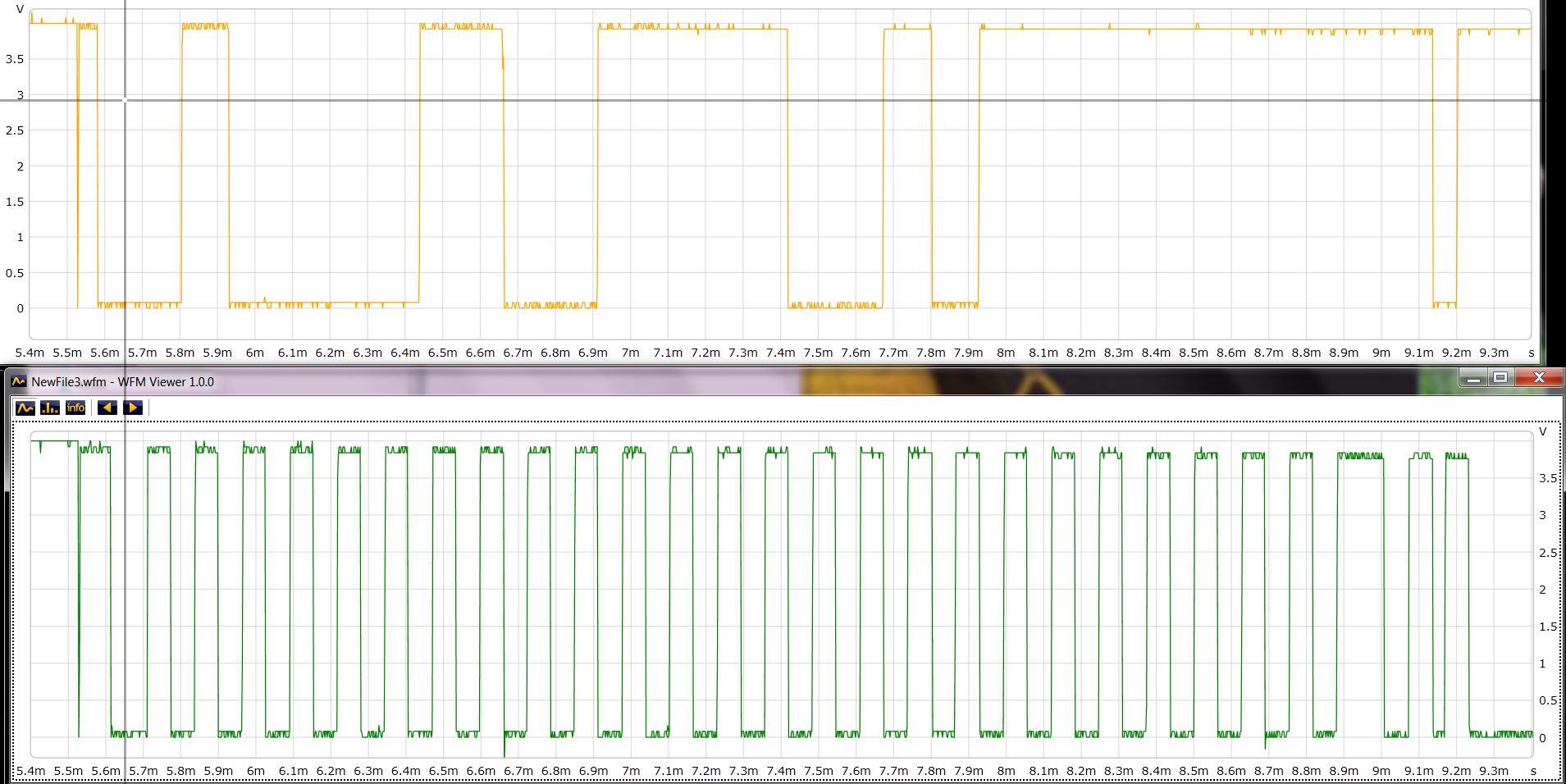

I'm using PCF8575 with LM3S6965 via bitbanging I2C. I read the first byte very accurately but having a problem reading the second one. I always get 0xff for the second. What I'm actually doing is that I first write to the port a random value like 0x7988 then the reading interrupt is activated to supposedly read the same value.
This is a piece of the code i'm running, while the writing occurs flawlessly I haven't it mentioned here:

Also, I'm attaching a picture of the waveform of the serial clock and data lines.
