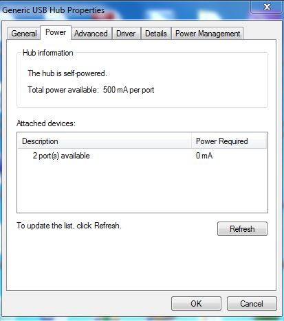

I am debugging a TUSB2046B designed by my team. It is currently detecting as a generic hub by windows. I am wondering this is right or should it be detected as as "TI TUSB2046B device " or as a "TI device"?

Hello Niranjan,
Yes, the TUSB2046B will be show up as a Generic USB Hub, the below image show the hardware id it should have.
Joel
Niranjan,
It seems to be a fault on the downstream ports.
Could you Send me the schematics for review. joel.jimenez@ti.com
Joel
