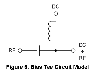

    Input signal range from FPGA to DS90LV019_pin2 is -0.099V to 3.06V.
    There might be a diffrence between an oscilloscope GND and a device GND,but if there is not so diffrence,is there a problem?

  • Hi Taichi,
    I would still be concerned about having DIN go below GND consistently if GND = 0V, since the FPGA will be providing a -0.099V for an input low. Will that -0.099V input low appear if both FPGA and DS90LV019  share the same GND? If that is the case, then if you could bias the signal to boost the signaling up by 0.5V so that it ranges from 0.401V to 3.56V instead, that may work.

    Currently both FPGA and DS90LV019 share the same GND , -0.099V input appear due to noise
    I need to bias the signal to boost .
    Still,I couldn't understand a reason of 0.5V boost you wrote.
    You mean that I should set signal level to a center of Input low voltage?
    And do you have any good idea of boosting signal? If possible,please post specific circuit.
    In this case,FPGA and DS90LV019 are connected by single end.

  • Hi Taichi,
    Since the input low ranges from GND-0.8V and input high ranges from 2.0V-Vcc, I suggested 0.5V bias as an example in order to place your input signal safely within the recommended operating range of the DS90LV019.
    I was wondering about using a bias tee to provide this offset:
    5611.Bias_Tee_Design_V2R.pdf
