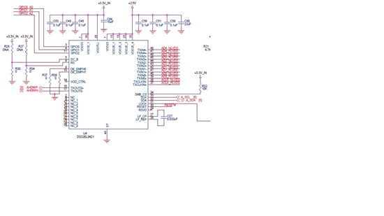

hi,
I'm trying to get my 0421/0124 to communicate. I'm using remote sense and dc balance. I'm seeing LVDS clock at the 421, but no output. I see that we left the resistor off of the VOD_CTRL. Can this cause no output?
thanks

Hi George,
You are correct. This pin requires a pull down resistor as described in the pin description section of the datasheet and also in Figure 11, the Typical Interface Circuit.
Glad you got everything working!
