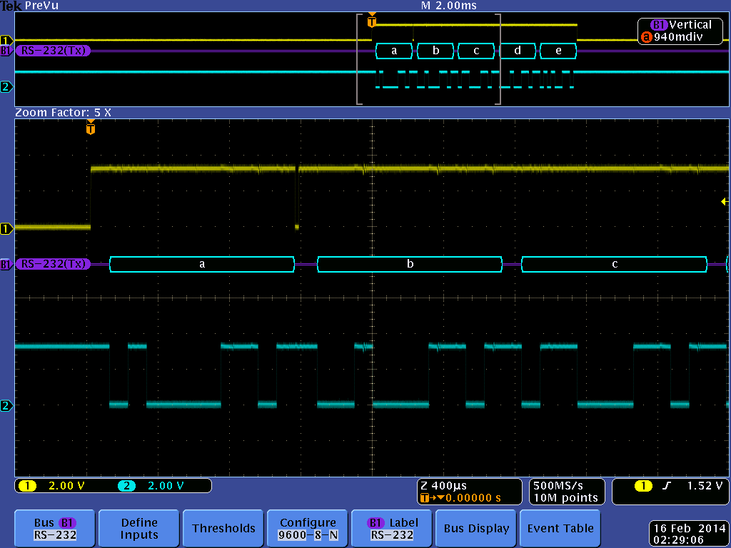

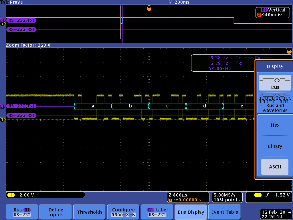

2. "One Baud Time" when 485EN = 1
The main reason I use TL16C752C is the automatic RS-485 flow control feature. However, when I set 485EN bit, all the outgoing characters on TX pin appear to have 1 extra bit.
I noticed that according to the datasheet, the DTR# will be asserted one baud time before transmitting data on TX pin. But when TX FIFO is enabled and there is some data in it, I don't think there should be the 1 baud time interval between characters.
I'm sure TX FIFO is enabled when I'm sending data, and AFR = 0x14 (only RCVEN and 485EN is set, all other bits including DLY[2:0] are cleared.
Below is the captured waveform. Channel 1 (yellow) is DTR#, channel 2 (blue) is TX. The TX data is in 8-N-1 format, but because of the "1 baud time", it looks like 8-N-2. And DTR# goes low for a short period after the first character, but stay high until all the characters are transmitted.
The correct 8-N-1 waveform should be like this (captured when 485EN = 0):
Any suggestions regarding this problem? I'm not 100% sure that I have completely understood the behavior of DTR# in RS-485 mode.

  • Hello Albert,
        Here you go the answers to your questions:
        1) Until now there is no new incoming version to solve the issue.
        2) After every UART transmission the system requires one clock cycle to get ready to transmit again. This will look like an additional stop bit.
        3)The DLY bits are actually 3 ( DLY[2:0] ) and are located on the 3 most significant bits of the AFR register, giving a maximum delay of seven bit times.
