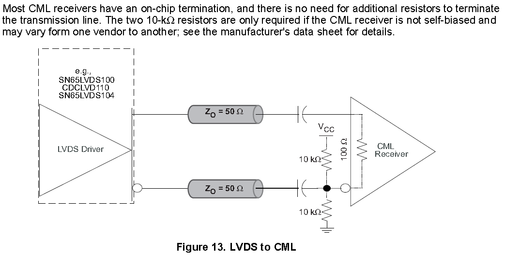

LVDS signals rely on a 100-Ohm termination at the output to terminate the transmission line and close the circuit, as shown in the app note LVDS to CML (http://www.ti.com.cn/cn/lit/an/scaa059c/scaa059c.pdf) diagram below:
Now, when looking at this LVDS to CML conversion figure, there are three things to note:
1) AC Coupling is required, in order to prevent DC drifting. Since you are using LVDS, AC coupling is also important to prevent against competition between two different common-mode voltages due to the difference between LVDS and CML.
2) There must either be a 100-Ohm termination at the output of the LVDS driver or the input of the CML receiver, otherwise LVDS signaling will not work. In this case, CML receiver possesses the 100-Ohm termination.
3) The 10kOhm can be omitted if the CML receiver inputs are internally biased.

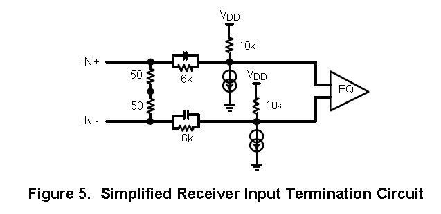

Now, looking at the input termination circuit for the DS32EV100, we see the following:
The 100-Ohm input termination across IN+/- is present as well as the terminal biasing with 10kOhm pull-ups to VDD. All that is left is to provide the appropriate AC coupling, and theoretically the DS32EV100 should work with LVDS.
