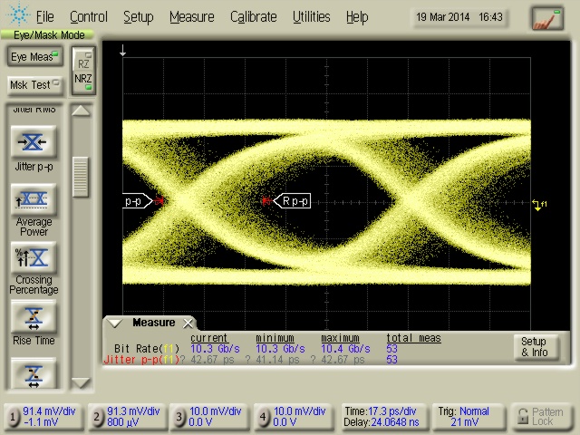

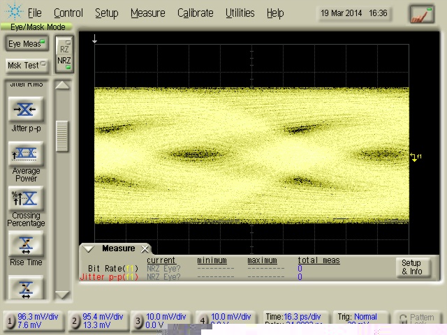

I actually tried putting the TI Retimer DS100RT410 into Ref_mode 0 mode per the TI datasheet, but I have my doubts as to whether it is bypassing the retiming mechanism. The output of the retimer does not look like the input – the output signal is significantly cleaned up as if it is being retimed. It is not possible on our board to physically bypass the retimer, then I ask if we are doing the right thing to make the Ref_mode 0 (bypass mode) work?
Generally the question is: is it possible to bypass DS100RT410 mechanism such way that it'll be transparent for input signal? If "yes", please send me exact procedure we need to do. If "no" is it reasonable to use DS100BR410 pin compatible device instead or any other solution you can recommend us?
