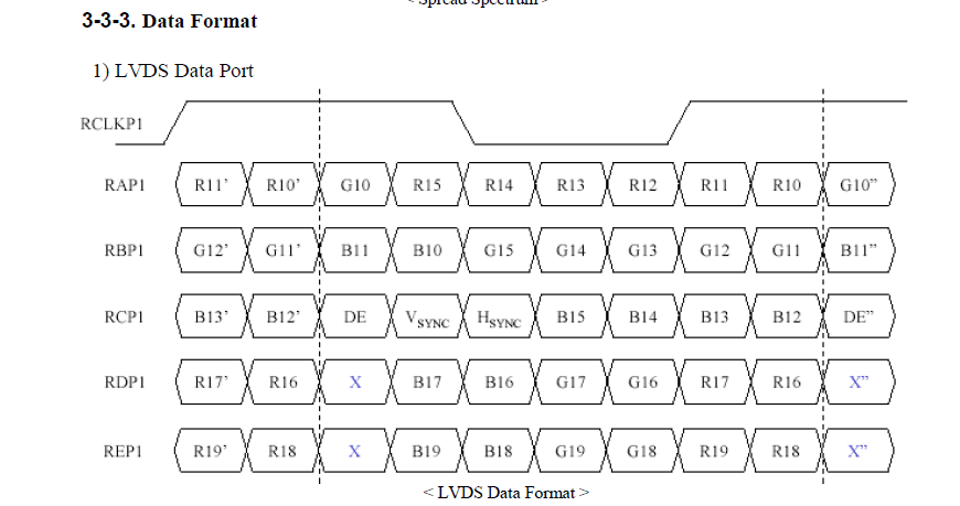

    So every LCD panel spec that I have looked at follows this LVDS mapping:
    This happens to be for a 10-bit panel. For 8-bit you don't need the last LVDS (REP1) and for 6-bit you don't need the last 2 LVDS (RDP1 and REP1). I literally just checked 8 different panel specs that I have to confirm this.
    Figure 17 of the DS90C387 makes perfect sense and matches what the panels expect. This makes sense if MSB connects to MSB and LSB connects to LSB but Table 3 in the DS90C387 doesn't seem correct or if you use that mapping then the output won't match what's shown in Figure 17.
