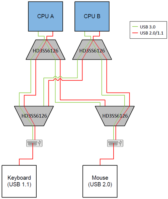

I have two USB ports which I want to support both USB 3.0 and USB 2.0. I have two CPUs (A and B), and I would like to be able to route each port to either CPU. I've found solutions for doing this with USB 2.0 (like the TS3DS10224), but nothing with both USB 3.0 and 2.0.
Here is a diagram; does TI have any parts that can function like the 'Crosspoint switch' block?
The closest thing I've been able to put together is using four HD3SS6126 2:1 USB 3.0/2.0 MUXs, as shown below, but obviously this isn't the most elegant solution. I couldn't find anything in the crosspoint switch portfolio or USB portfolio.

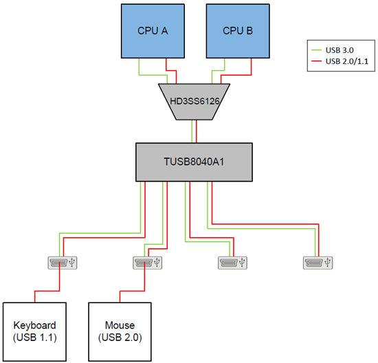

  • Hi Diego,
    I attached below a block diagram with your suggested configuration.
    Is the connection between the TUSB8040A1 and the HD3SS6126 going to be a significant bottleneck (since only one CPU can effectively use the USB hub at a time), or is there enough overhead in the USB standard that this wouldn't be a major concern?
    This may be some ignorance of the protocol on my part, but if the keyboard is going to CPU A and the mouse to CPU B, and the HD3SS6126 is switching back and forth between the CPUs, is there an issue of losing packets as the HD3 is switching, or is this accounted for at some point and the suggested configuration is 'tried and true'?
    Thanks for your insight on this.
    Jonathan Bender
  • Hello Jonathan,
        Per USB specification, the bus has a tree topology with only one USB HOST. And on your system, each CPU is acting as a HOST, therefore you cannot have both CPUs connected to the same USB tree at the same time.
        Now, regarding to the behavior of my proposal: The HD3SS6126 will connect the TUSB8040A1 only to one of the CPUs, after the connection is between the HOST and the HUB is established, the HOST shall enumerate the HUB and all the connected devices to its downstream ports. On this way, the HOST will get complete access to the USB tree and all its devices. Each time you change the connection by means of the HD3SS6126, the selected HOST will initiate the USB enumeration process, meanwhile the other processor will lose the USB connection.
    Diego.

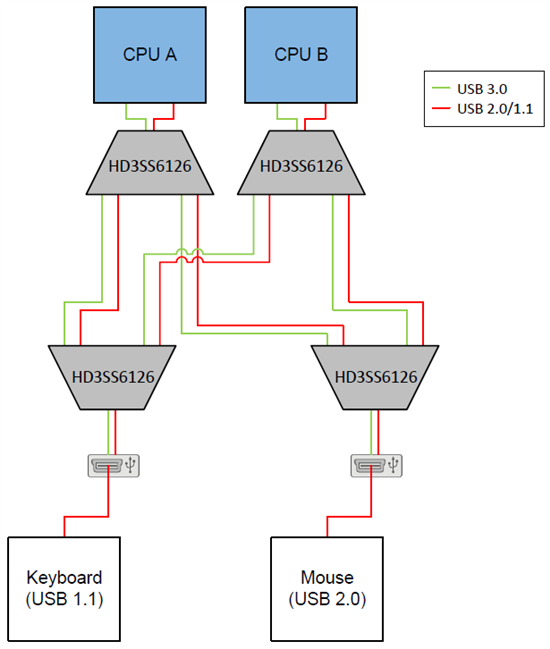

  • Hi Diego,
    I don't have any other application information currently other than what I've provided.
    In the below block diagram, if I had the HD3s switched internally as the lines show, would that work?
    If I wanted to put the mouse on the other CPU, for instance, I would switch the bottom-right HD3. There would only be a single host CPU per downstream device connected at a time. This is the closest approximation to a USB 3.0 / 2.0 crosspoint MUX I have been able to create.
    Jonathan Bender
  • Hello Jonathan,
        The implementation is possible with the following restrictions:
        Each time you select a complete path between one processor and one device, the Host (CPU) will enumerate the attached device and this last one won't be accessible until the enumeration process is completed.
       Depending on the configuration of the HD3SS6126, The processors will be able to operate the devices as follows:
    • CPU_A connected to DEVICE_A and CPU_B connected to DEVCE_B.
    • CPU_A connected to DEVICE_B and CPU_B connected to DEVCE_A.
    • CPU_A connected to DEVICE_A only.
    • CPU_A connected to DEVICE_B only.
    • CPU_B connected to DEVICE_A only.
    • CPU_B connected to DEVICE_B only.
    • NO accessible devices.
    Is this what the customer wants?
    Diego.

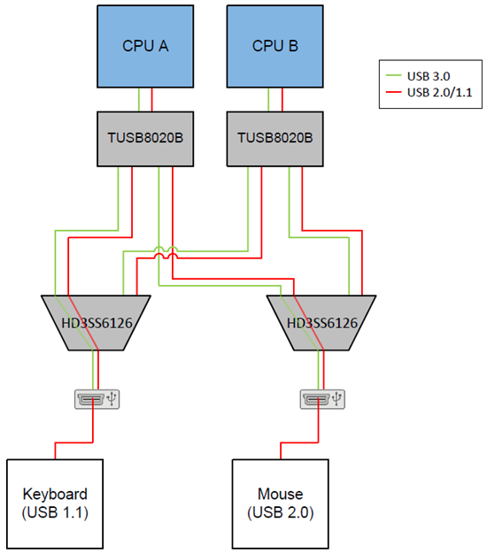

  • Hi Diego,
    I understand, thank you for that thorough explanation. All of the listed use cases are desirable.
    One final question; if in addition to the above use cases, we wanted for instance to have DEVICE_A and DEVICE_B connected to CPU_A at the same time (or CPU_B), could this be possible if the top two devices were TUSB8020B (as shown below)?
    Thank you very much for your expertise,
    Jonathan Bender
  • Hello Jonathan,
        It is impossible to have more than one device connected to the same Host port, the only way to have more attached devices is by means of a HUB (the first approach that I suggested).
    Diego.
  • Hi Diego,
    Understood, and the TUSB8020B in the above diagram is a hub, with the single upstream connection to the host (CPU A or B). The HD3 switches just switch DEVICE_A and DEVICE_B between HUB_A and HUB_B, so this configuration should be okay, correct?
    Jonathan Bender
  • Hello Jonathan,
        The implementation is correct, the TUSB8020B will bring the capability of connect up to 2 USB devices on each HOST, meanwhile the HD3SS6126 provides the flexibility to select between the HOSTS to each USB device.
       I suggest you to get more information regarding the application, maybe we can find a simpler implementation for the customer.
    Diego.
