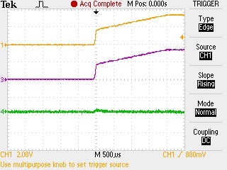

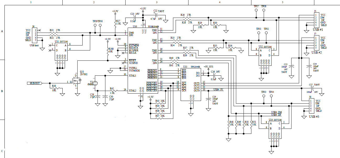

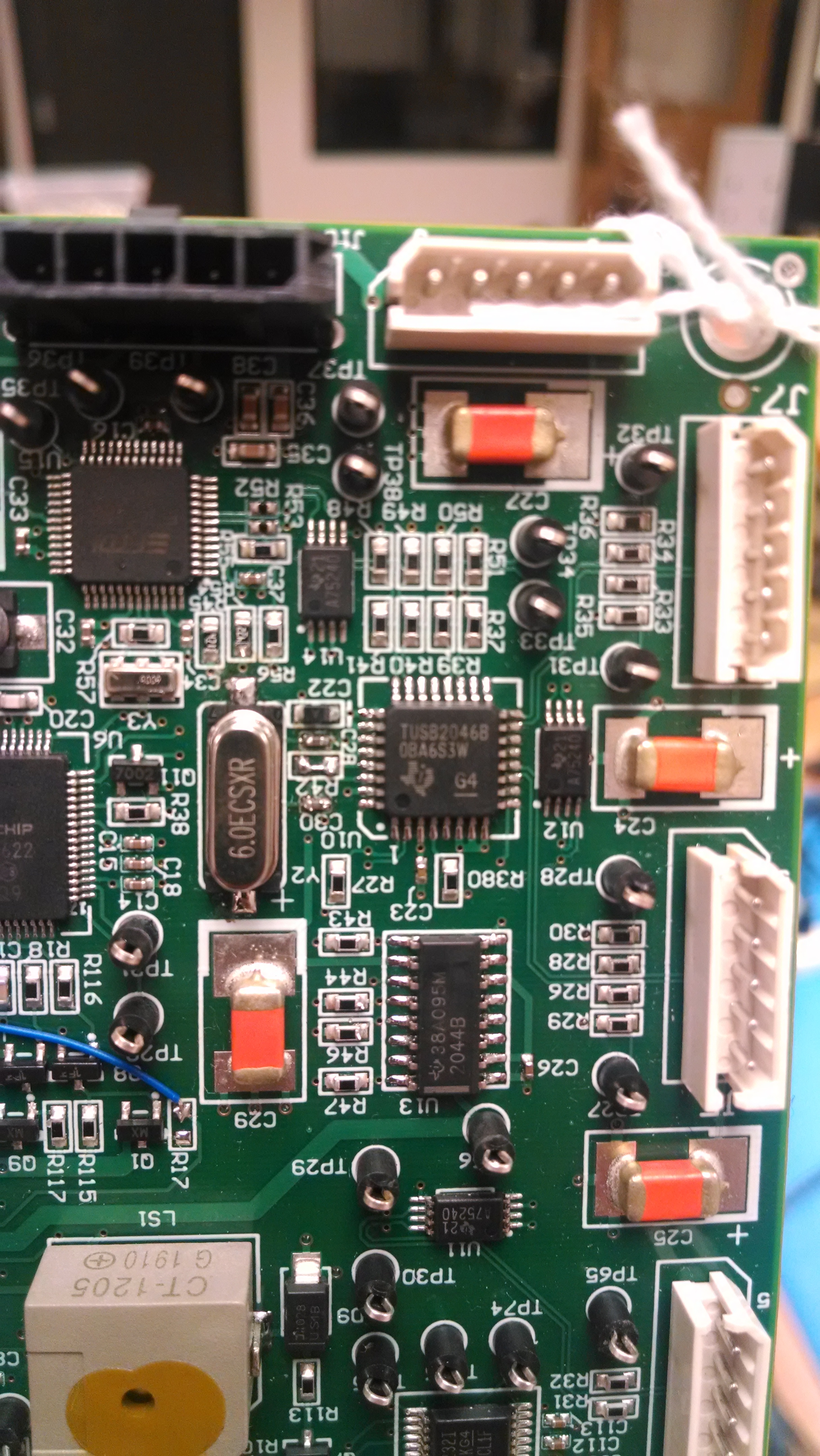

My company is using the standard 6MHz oscillator circuit design described in Fig 6 of the TI datasheet for the TUSB2046B hub controller.  Perhaps 20% of our new boards are coming back with a dead oscillator within months of use.  I have been able to repair them temporarily by replacing the IC and/or the 27pF capacitors, only to find out the next day that the problem has come back.  Either the design is marginal, or there is a PCB layout issue, or something else I haven't yet identified.  Looking for a permanent solution!
Here is what I've tried, but each case to no avail:
  1. Substituted a 5K potentiometer in place of the 1.5K start-up resistor.  I adjusted it down to 200 ohms, and adjusted it up – after turning power off each time.  No value even got close to starting the oscillator.
  2. Replaced the ECS crystal ECS-60-20-5PX-TR with an equivalent FOX crystal.
  3. Changed the 27pF caps to 22pF caps (0402 package SMT)
  4. Changed the 27pF caps to 30pF
  5. Applied both a heat gun and a cold spray can to see if temperature had an effect.
  6. Added a 1000pF cap across the 0.1uF bypass cap on the power pins of the hub controller IC.
  7. Added a 10uF cap across the 4.7uF tantalum filter caps on the hub controller IC.
  8. Removed the 4.7uF tantalum filter cap across the IC, leaving 4uF of capacitance due to other IC's on the 3.3V power supply.
Several times the oscillator worked for a while after I replaced the 27pF caps with an equivalent NPO 0402 and 0603 package.  In two of those cases, I washed the surrounding PCB area with alcohol, and found the oscillator died again.  After drying out a while, it again worked. But after a few hours, it died again.  Similarly, replacing the IC itself appeared to fix the oscillator problem, but only temporarily.
