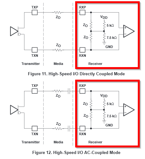

Does the TLK1521 has internal termination on the DINRXP/ DINRXN terminals?
The datasheet of the TLK1521 suggests that the device contains internal input termination on the DINRxp & DinRxn serial inputs (Figures 10 & 11). I wish to varify that. A fellow co-worker claims that TI technical support rep told him that there isn't.

    The TLK1521 does have internal termination and figures 11 and 12 in the data sheet outline this:
    Note that RXN and RXP represent the pins of the TLK1521. Please let me know if you have any additional questions.
