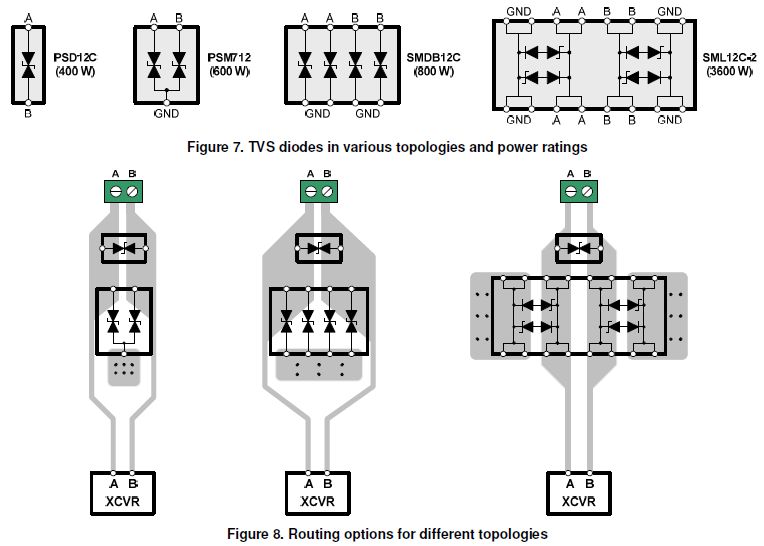

    There is one more questions that I would like to ask you.
    If we guarantee more than 400W,Should TVS diodes be placed as below?
    Kato
  • Hi Kato-san,
    If you are worried that in your application there may be transients (surge or EFT) that could be greater than 400W, then yes I would definitely recommend placing some external protection as close to the connector as possible.
    The SM712, is a very popular TVS protection diode that I would recommend. It has built in asymmetrical standoff voltages (-7 to +12 volts) like the  RS485 standard. In terms of layout I would place the device as close to the connector leaving the module as possible with the I/O 1 and 2 pins pointing towards the connector. This makes it so the transient energy is not forced to divert from the signal path to reach the protection device. Lastly we recommend placing multiple vias in parallel to a GND plane to lower the inductance of the return path.

  • John-san,
    Thank you very much for your reply.
    If there is transients that would be greater than 400W in our customer's application,
    I would recommend them placing some external protection as your comment.
    The figure that attached previous E2E is the source of SLLA292A-Application Report.
