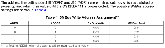

    To boot from the SMBus in Master/EEPROM mode, you will need to leave the ENSMB pin floating. I am currently unable to find the user's guide for the DS110DF111EVM, but the DS125DF111EVM User's guide will be helpful, since it uses the same PCB layout (http://www.ti.com/lit/ug/snlu158/snlu158.pdf). This information is detailed on p. 7 of the User's Guide as well as p. 11 of the datasheet. Note that this is a setting for an input pin of the device, and setting up the DS110DF111EVM in EEPROM mode is not handled by a register setting.
    You can set the address on the DS110DF111EVM by manipulating the J16 and J10 pins as shown below:
    Michael

  • Hi Ryuji-san,
    When running the DS110DF111 in EEPROM (or SMBus Master) Mode, the device should immediately return to Slave Mode after the EEPROM parameters are loaded into the DS110DF111, so after EEPROM is read, the customer should be able to communicate with the EVM via a GUI like ALP.
    Can you have the customer check a few things to ensure that the EEPROM is being read properly?
    Keep ADDR0 and ADDR1 pins floating on the EVM so that the address is set to default 0x30h. This is not a programmable address within the SMBus registers. The address is set manually via ADDR0 and ADDR1 pins on the EVM board.
    On the ADDR1/#DONE pin 10 of the DS110DF111, check to see if the output goes low to ensure that data from the EEPROM has completed being read.
    In the ALP GUI, the default channel that you will see on the "Channel Registers" tab is Channel 0, and you should be able to read directly from there without reading/writing to Register 0xFF. However, if you are running any script to program the EVM and not using ALP to change channel register values manually, you will need to set up the Shared Register Address 0xFF to talk to the desired channel.
    Michael
