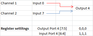

  • Hi, Inigo,
    I have set up the test in lab. And it works well when switch operation.
    You can set like this according to your design.
    I chose the input port 0 and input port 7 as channel 1 and channel 2. And output port is output 4. The register setting mainly you should set is output port 4 and input port 4.
