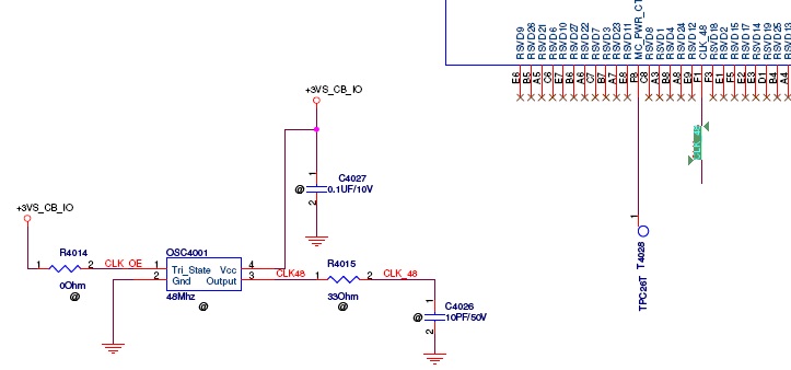

our customer want our PCI4512 latesed Datasheet and schematic, due to it's not available on Web, customer also want to know the CLK_48” Pin function, is there any problem if not connect this pin?
