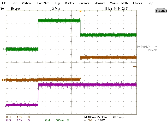

I have a development board that installed a TUSB1310A.
I notice one board has a common mode voltage of 500mV on TX DP and DM pins.
Even though I force a reset to this phy chip, the common mode output remains .
What can cause this symptons?

attached is schematic.
The TX DP and DM will rise to 500mV when power rails are all up.
Even though I assert the reset signal to low, it does not force this common mode voltage to low or 0V.

While you maintain RESET# asserted, the TUSB1310A disables all its internal logic. The voltage measured when the device is held in reset should be induced by the board, can you take a scope capture showing the ramp-up of Vcc and this voltage.

They should connect terminals JTAG_TRST to ground, this could be causing the TUSB1310A entering in test mode.

Another thing that could be causing is an incorrect assertion of OUT_ENABLE at power-up, this terminal shall never be asserted before the 1.8V rails is valid.
