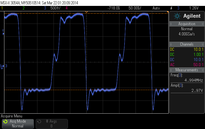

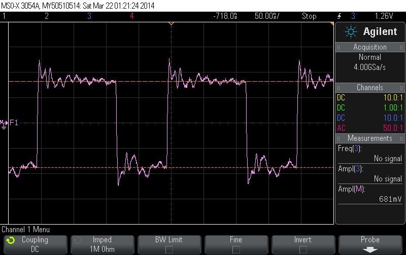

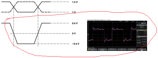

I am using the SN65LVDS1 driver unit to send a clock signal to an ADC. Prior to plugging up the ADC to the LVDS1 unit, I was testing the output of the LVDS driver unit and am seeing a 600mV output across the two output legs (using a differential probe).
I am powering the driver with 3.3V, measuring the output across a termination resistor (100ohm), and giving an input of 3V to the signal (circuit attached). I checked my probe settings, made sure everything was grounded, and verified that the input signal (to the LVDS unit) was 3V.
Has anyone else experienced this issue/are there known issues with this unit?
