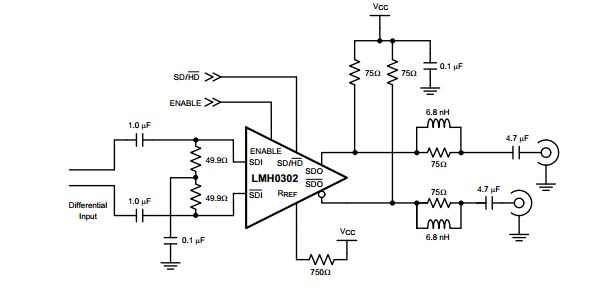

    LMH0302 inputs are self biased so there is no need for the common mode level shift. Please note below for a recommendation:
    Regards,,nasser
  • Hi Nasser
    I was referring to the inputs on the LMH0366.
    Riaan
  • Hi Riaan,
    Sorry i was still thinking about LMH0302.
    LMH0366 has wide Vcmi dynamic range(0 to Vcc) so i am not sure why you want to level shift to 1.2V. But you can AC couple and level shift as long as you meet impedance requirements.
    Regards,,nasser
