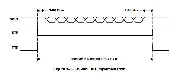

I have some questions regarding the TUSB3410, working in RS485 mode.
Our design is based on the schematic, shown on page 19 in the TUSB3410's datasheet:
SOUT, SIN, RTS and DTR are connected to the RS-485 transceiver (SN65HVD11).
For the firmware we have tried one, that we found in TI's forums (0842.RS-485.zip), but the device works only in transmit direction. It seems that this firmware controls only the RTS pin. DTR remains unchanged all the time.
Could you please provide us with a working firmware and PC driver pair for RS485 bridge aplication?

      Please note the RS485 use hardware control protocol since it’s a half-duplex operation, could you please verify that you are using this configuration on your software? Please follow the recommendation and in page 12 - figure 3-3 on the Data Manual. (http://www.ti.com/lit/ds/symlink/tusb3410.pdf)
      Also could you please provide us your schematic in order to verify that everything is correct

    I think that firmware you pointed me to is the same, that I'm currently using (I compared the both files binary). The firmware in my case is burned on an external 128k EEPROM. I also modified the .inf file for the driver - I commented out the lines, which contained the "umpf3410.i51". As result - the device works, but only RTS signal changes its state. DTR is always HIGH, so the 485-transceiver works only in one direction.
    Today I tried to cut the DTR trace from the tusb3410 and to use only RTS for both RE and DE pins on the 485-transceiver (shorted pins 2 and 3 on transceiver). This way the device works as expected - in both directions. But should I leave it this way? What could be the reason for the DTR signal not working?

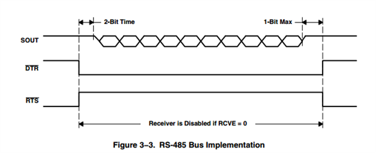

                Sorry for the delay on this, the reason of why it’s not working is because the DTR (active low) signal  transceiver on the example (page 12 ) is denied (DTR_n) and the transceiver that you are using (SN65HVD11) this signal is “active high”.
                    You can leave the signal shorted pins 2 and 3 on transceiver since RTS/DTS are opposed signals, please take a look on the following graphic
