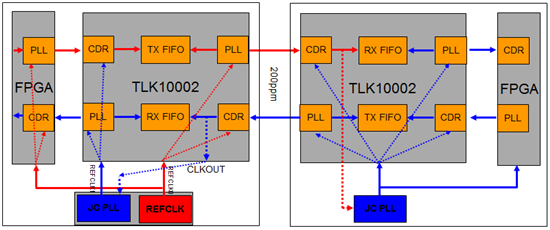

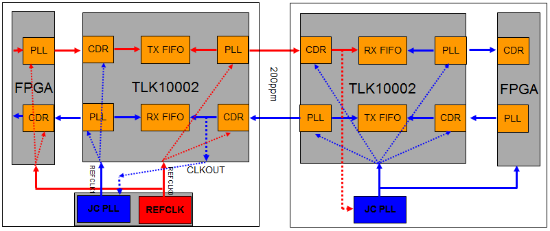

    The line rate is based off of the reference clock frequency so obviously if your reference clock frequency is +200ppm faster than your line rate will be scaled up by the same percentage. The statement on page 16 of the data sheet is acknowledging the fact that your incoming line rate needs to be within 200ppm of the local reference clock so that the data can be recovered properly. So, if your incoming data is +200ppm and your local oscillator is -50ppm you would be outside the 200pmm spec of the part and the serdes would not recover the data or clock correctly on the remote board.
    In your case this is not the issue. Your local clocks are within 0.5ppm of each other and the HS portion of the remote TLK10002 is operating properly. The problem lies in that the HS and LS portions of the remote chip are not in sync with each other. So data is being put into and taken out of the RX FIFO at different rates which is causing the FIFO collisions.
    The way to fix this problem is to take the CLKOUTxP/N and feed it through the jitter cleaner which in turn will be given back to the TLK10002 as the new reference clock. You will have to use both reference clock inputs on the TLK10002, one for the local oscillator and one for the jitter cleaned version of the recovered clock. In software you will need plan for this switch during configuration. You will initially start with the local oscillator and then switch to the recovered clock some time after. The diagram below should help you understand what I am talking about.

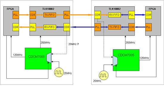

  • Hi Michael,
    The shown above is our board current setting. To my understanding of your instruction, i just need to switch the reference clock on one card either locally or remotely to the output of TLK10002 as a new reference clock after its initialization. Make it become a slave one to sync on the other side which let's call a master. Am I right? Please advise.
    If it is true, what is minimum output frequency out of TLK10002? Could it be 25MHz? I suppose we must us the data stream not from the receiver pll as a source. Right?
