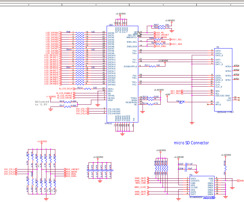

Hai I am try to interface tfp410 with LPC3250 controller through hard ware not by i2c interface
connections are as below
PD pin is connected to 3.3V through lpc3250 GPO
ISEL is low. ->I2C disabled
EDGE is high ->Rising Edge
BSEL is high -> 24 Bit
DKEN is low ->DSKEW Enabled
CTL1 CTL2 CTL3 are high
HSYNC and VSYNC are connected to COntroller
and DE is High
all these controlling pins are enough or can I change any values
And I am tested with different resolutions in my code
     Resolution         Output on monitor
    320X240                Input not supported
    1024X768              Horizontal lines are getting.
I am struck here can any one suggest me or can I interface through I2C only
