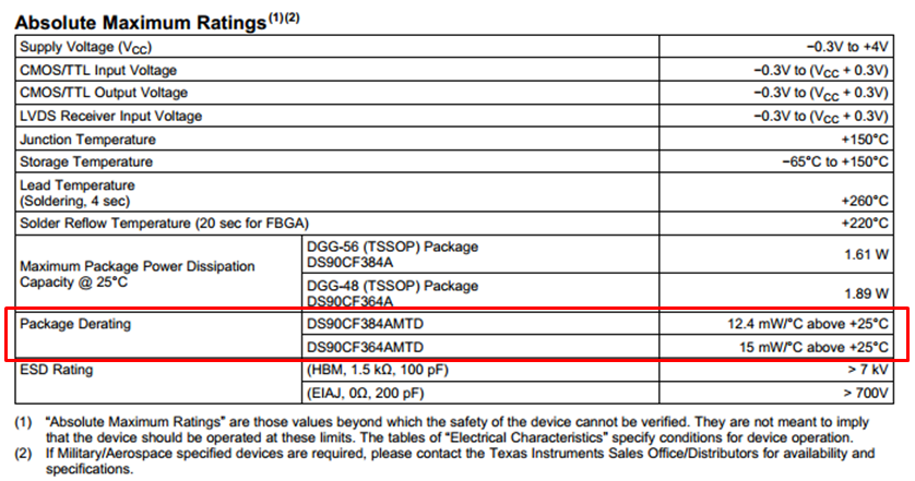

My customer uses the DS90CF384AMTD/NOPB.
He wants to know Package Thermal Resistance value.
Please tell me the Value.
Package: DGG-56(TSSOP)

    The thermal resistance is given in the form of "package derate", which is the inverse of thermal resistance (degrees C/W). Please refer to the abx max table below:

    How about a junction-to-case thermal resistance?
    My customer check a temperature of top of case.
    So he wants to know a junction-to-case thermal resistance.
    Naoki
  • Hi Naoki-san,
    Unfortunately, the datasheet does not have this information, and I have found only limited resources about what the exact junction-to-case thermal resistance (Theta-JC) of the CF384A could possibly be.
    As mentioned before, the Theta-JA can be calculated by taking the inverse of the derate, so 1/(0.0124) = 80.64 (C/W). I have found that for a similar 56-pin TSSOP package on an NSC legacy DS90CR581/DS90CR582, the junction-to-case thermal resistance is around 24-26.2. I cannot guarantee that the DS90CF384A will match within this range, but the figure should be a reasonable starting point.

    Because he can only check the package temperature, he wants to know Theta-JC.
    I hope  that parameter will be mentioned on the datasheet someday.
