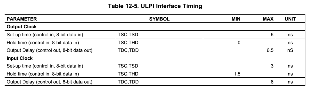

  • Hello Kishore,
       These are the ULPI timing characteristics:
    RESET_N input pin timing spec:
    tw(POR) Internal power-on reset pulse width 0.2 µs
    tw(RESET)External RESET_N pulse width: 8 CLOCK cycles (Applied to external RESET_N pin when CLOCK is toggling.)
    The output accuracy is highly dependent on the input clock on REFCLK and shall be similar to it.
    The electrical characteristics for the digital inputs are the following:
    For: CLOCK, STP, NXT, DIR, DATA[7:0]
    VOL_MAX:0.45V            VOH_MIN:VDDIO-0.45V
    VIL_MAX:0.35*VDDIO    VIH_MIN:0.65*VDDIO
    FREQMAX:30 MHz      LOADMAX: 10pF
    RISETIMEMAX:1ns      FALLTIMEMAX:1ns
    FREQMAX(only for CLOCK): 60MHz
    For: CS, CFG, RESETB input pins
    VIL  0.35 * VDDIO
    VIH 0.65*VDDIO
    Diego.

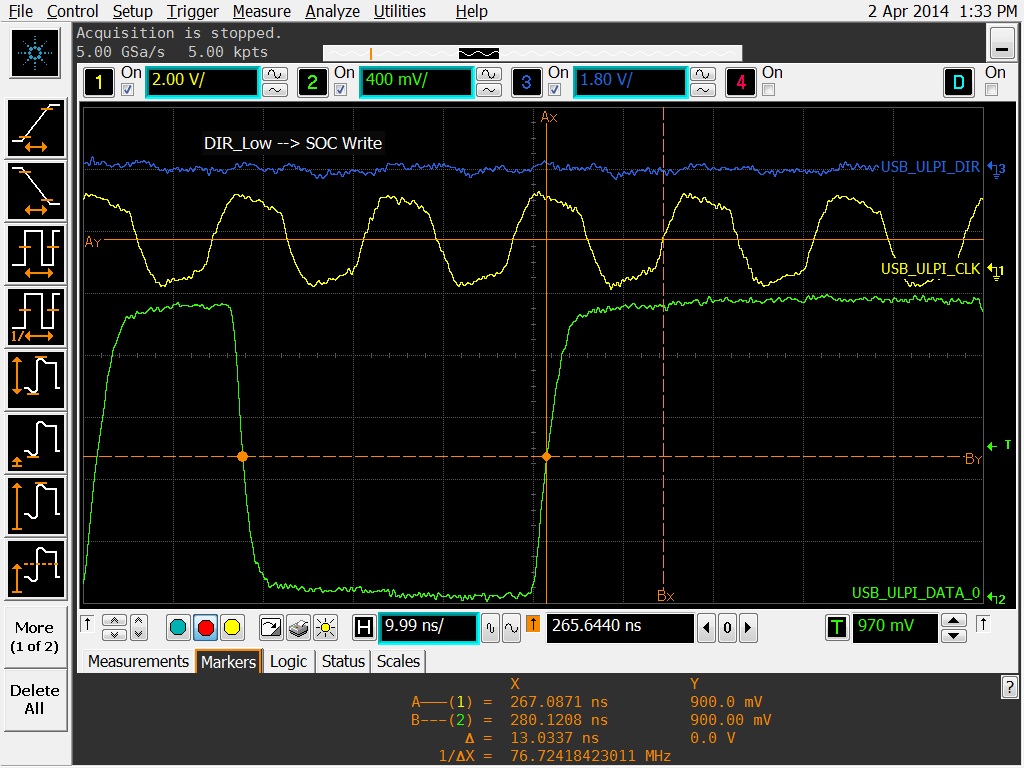

    1. As per the ULPI specification timing (shared by you), Setup Time should have a maximum value of 6 ns. Our captured setup time (of DATA0) is 13.0337 ns (Please refer below scope shot). As per the spec it is failing, but functionality (ULPI communication between Link and PHY) is met. We hope the setup time required by TUSB1211A1ZRQ, to properly recognize data should be given as minimum 6 ns. Kindly clarify.

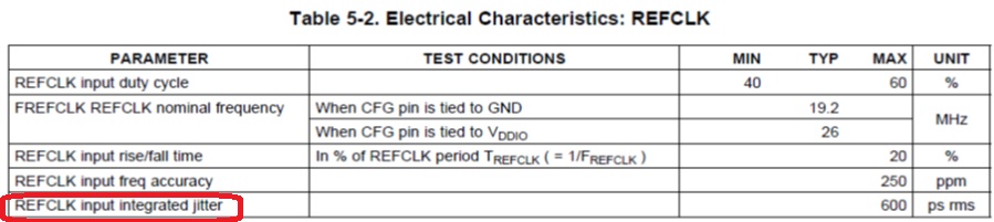

    2. In the REFCLK electrical characteristics, we could see 'REFCLK input integrated jitter' should be maximum 600 ps rms. Kindly let us know the range of frequencies over which the 'Phase Jitter' has to be computed.

  • Hello Kishore,
       To clarify the information:
        1) Your assumption is correct, the setup time is a minimum (sorry for the mistake).
        2) First I need to know the implemented clock mode. Unfortunately the ULPI specification does not provides jitter requirements for this stage.
        3) The rise and fall times are output specs, don't worry about it.
    Diego.

    2. As I've previously mentioned, we could see a parameter named "REFCLK input integrated jitter" in TUSB1211A1ZRQ datasheet (refer below snap shot). You've previously clarified that the term actually means "Phase Jitter". Phase Jitter is usually computed from Phase Noise which in turn is computed between a frequency range. Kindly let us know the frequency range over which phase jitter has to be computed.
    3. Kindly let us know if any best known method is available for computing Phase Jitter (like the range of frequencies over which it has to be computed, nominal noise floor of the scope, suggested probes (single ended low input impedance/high input impedance, differential, etc), total population/clock cycles to be considered,etc).
    Kishore Kumar
  • Hello Kishore,
         Since there is no official jitter spec for ULPI, the integrated input jitter was characterized under 600ps rms. On the other hand, this device was supported by other group which is no longer on TI and we do not have the entire characterization data. However not everything is lost, hense the measurement can be approximated by means of the period jitter instead the integrated jitter.
    Diego.
