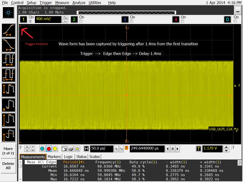

Our REFCLK frequency is toggling between 19.18471MHz to 19.2131MHz (CFG pin is tied to ground in
TUSB1211A1ZRQ). Measured jiter value is around 30ps and it is very well within the range.
The output CLOCK generated by TUSB1211A1ZRQ, is toggling between 59.8045MHz and 60.1814MHz in steady state. But in ULPI specification, the Steady state frequency is mentioned as 59.97MHz to 60.03MHz, measured value is out of this range.
Kindly clarify the reason why the output CLOCK frequency is not within limits.
Kishore Kumar

Hi Diego,
Please find the below scope shots.
REFCLK Input:
7585.USB_ULPI_REFCLK_Jitter.zip
CLOCK Output:
As per the ULPI specification, the OUTPUT clock should get into steady state (Frequency lies between 59.97MHz and 60.03MHz ) within 1.4ms from first transtion. But in our case the clock frequency is not within that range (Toggles between 59.8045MHz and 60.1814MHz).
The clock frequency is not within the steady state limits even after 10ms (it is not getting stable even after minutes) from first transition.
Kindly clarify.
Kishore Kumar
