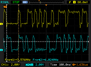

  9. Start video capture (or alternate control application). HERE IS THE PROBLEM: When I start the sensor the LOCK led goes from HIGH level to blink.
I tried to take a photo with OV2640 and doesn’t work. I can observe the led LOCK is blinking like the capture attached.

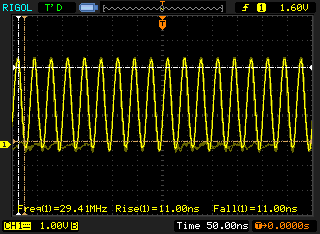

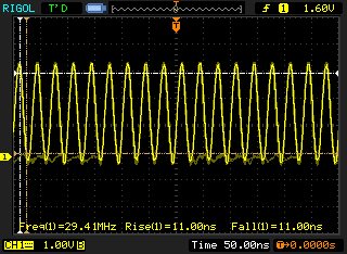

This is my PCLK from the sensor OV2640

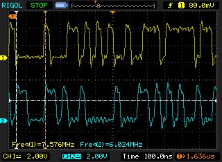

This is my PCLK again with DATA0

  • Hi Guillermo,
    Can you measure the jitter on the PCLK coming from the OV2640? The sensor datasheet doesn't give a spec. Also, you can check register 0x0C bit 2, PCLK Detect, to see if the 901 is seeing a valid PCLK. Since it seems like the problem is intermittent, you can try reading that register repeatedly and make sure that it is consistently good.
    Jason Blackman

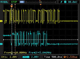

  • Here you have more pictures describing the problem:
    Yellow: D0 901 Input  from the sensor OV2640
    Blue: D0 902 Output
    The serdes starts working but suddenly it doesn't work.
    Any help with that? We are trying to measure the Jitter since we have never done it, we'll see if we can do it.

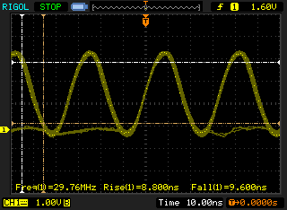

  • Hi Jason,
    This is the Period Jitter of PCLK from the sensor
