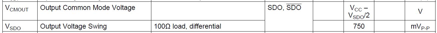

Our customer has evaluated to distribute the differential output from LMH0344 by using DS25CP102, then I understand that the DS25CP102 can receive the output from LMH0344 directly, it means that the AC coupling or any bias are not needed. Is my understanding correct?

LMH0344 output
DS25CP102 input

    I believe it is fair to say that the LMH0344 and DS25CP102 can be connected together directly due to matching specs for output voltage swing and common mode voltage. However, there is no real indicator that the LMH0344 output is an LVDS signal. It is still a good idea to have an AC coupling cap between LMH0344 SDO and DS25CP102 IN for noise filtering and overcoming any discontinuities in the common mode voltage expected on the line. Choice of cap value will be dependent mainly on the length of the longest pulse.

    Regarding the previous discussion of AC coupling, I have been able to derive more feedback about whether DC coupling or AC coupling should be used. I have verified that DC coupling will in fact work, since CML can be coupled into the wide-band LVDS input of the DS25CP102. In addition, DC coupling simplifies the design because there will not be a dependency on the longest pulse duration (i.e. a long string of 1's and 0's will not cause the DS25CP102 input node to float). AC coupling has benefits of interfacing two different common mode voltages (typically LVDS signals have common mode of 1.2V, though common mode can range from 0.05V to Vcc-0.05V) and preventing against input transient fault conditions. There will also need to be data dependency considerations, as long pulse durations will affect the cap value, as mentioned before.
