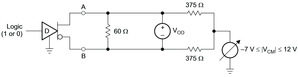

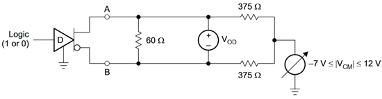

  • Hi Jayden,
    1) That definition is generally true.  An RS-485 compliant driver must be able to drive a differential voltage greater than 1.5V when driving an equivalent load of 32UL.  You may have seen the following definition for VOD in the RS-485 specification, and indeed 375ohms is equivalent to 32 1UL receivers (12kohm / 32 ).
    2) A 1/8UL receiver has an input impedance that is 8 times larger than a 1UL receiver.  The input impedance of a 1/8UL receiver is ~96kohm, and the input impedance of a 1UL receiver is ~12kohm.
    3) The Unit Load rating of a receiver is typically specified relative to the input leakage current of its receiver input pins.  That is, a voltage is applied to the receiver input pins A and B ( typically -7V to +12V ), the input current is measured, and the quotient is the input impedance of the receiver.
