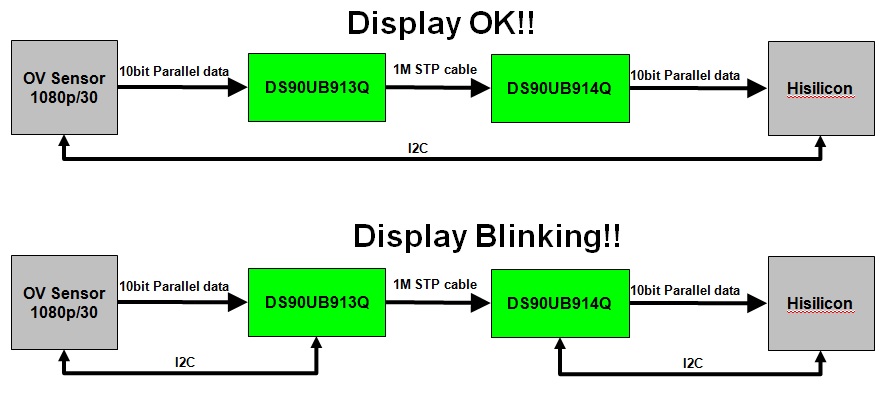

When I use DS90UB913/4 to connect  with OV image sensor (1080p/30) and without connect I2C bus ,the image display  is seems like normally
But If I use CMOS sensor and Host's  I2C to control 913 and 914 ,Output image will be blinking
Please refer to below link and give us some way to solve
https://www.youtube.com/watch?v=Q06JWV8LG3M&feature=youtu.be

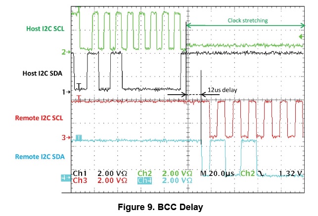

Please refer to below link n
