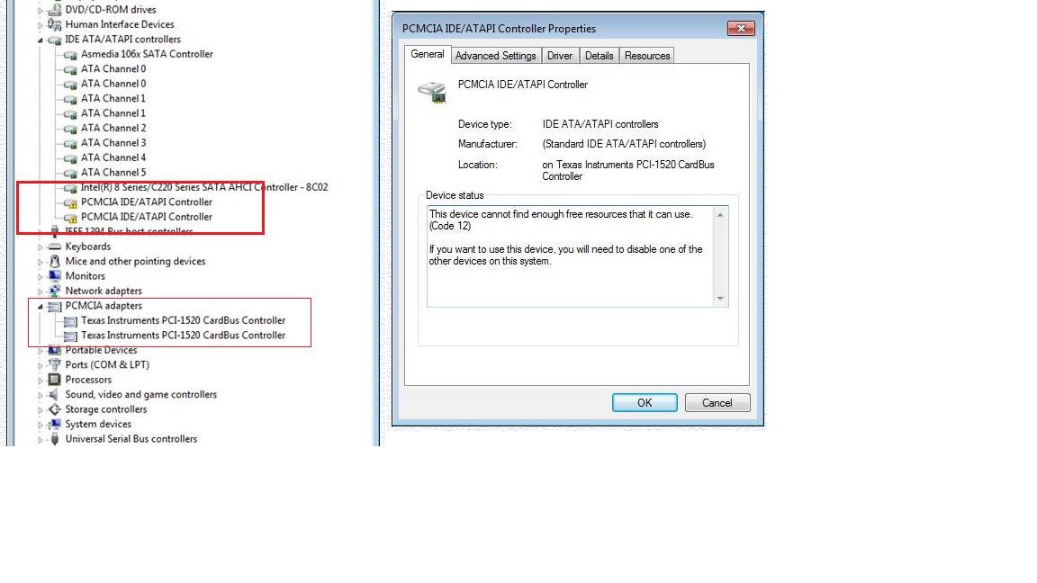

We are in the process of configuring a Computer System with the PCC20 Card Reader[PCI1520] and we are having problems.
The issue is with Windows 7 Pro 32bit and 64bit versions. (Windows 8 works ok)
The main problem is that the OS cannot allocate resources for any of the PCMCIA Cards, we have tried Memory Cards and Digital I/O  Cards with the same results.
Please see the below picture of the problem reported by windows.
Do you have any idea what could be causing this problem?
