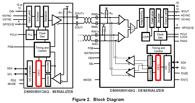

I have one question for DS90UB913A.
What is the purpose of the FIFO before I2C Controller block?
Thanks... C.W. :)

The I2C data is transported across the same physical connection as the video data, but the clock domains are different. Whenever you have different clock domains, there is a requirement for the data to be buffered between the two clock domains.
