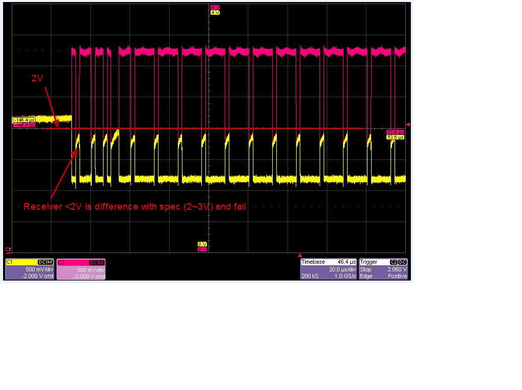

  Customer used datasheet Figure 3 circit to test thechip recessive DC level, but it is around 1.8v.The datasheet showed 2V min. It could not pass customer testing certification. And another strange thing:when CANH add 180pF to grounnd ,CANL add 56pF to ground, that recessive DC level was passed.
If the waveform, pink is CANH,Yellow is CANL.
  • Hi Thomas,
    Can you get a scope shot of VCC pin as well? Also could you share the schematic? I would like to see what the bypass capacitor value(s) on VCC are, and if the SPLIT pin is being used.
    Lastly, are there other nodes attached on the bus creating a network? This could be a result of a ground potential difference pulling the local bus voltage down.
    John

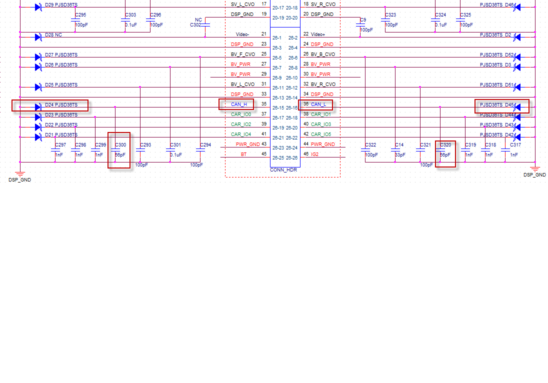

  • Hi John:
    VCC is 5V. SPLIT doesn't use, because their CAN transceiver is not in terminar side.
    I pasted their circuit and CANH C300= 56pf and 180pf waveform.
    It seems CAN H charging time longer (300pF) that improved  CANL charging time faster.
    Is it right? or some side effect?
  • Hi Thomas,
    When you are performing these tests, are there other nodes on a network connected? If there are, I would be interested to see if you still have this behavior if you disconnect the node from the network.
    This looks to me like there is a ground potential difference between some nodes on your network. If you look at the first picture the recessive level is rising over time. From the transceiver points of view, the recessive state is biased very weakly (>12kΩ to VCC/2). That is why I asked for you to include a screenshot with the VCC level. If this voltage is drooping than the common mode voltage of the device will as well. Another option is if another node on the network is at a different potential it will pull the common mode up or down accordingly.
    I can recreate very similar waveforms using 5 volt and 3 volt CAN transceivers or simply by injecting an offset voltage between nodes.
    http://www.ti.com/lit/pdf/slla337 - see page 5 of this app note for the 5 and 3 volt CAN example.
    Lastly, I believe that with larger bus caps the behavior lessons, because you are holding the node voltage of where you are monitoring more stable.
    Please try disconnecting this node and measuring the bus voltages again.
    John
