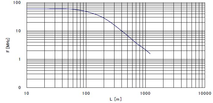

When our custmer's system is 40Mbps,does the length have to be < 50[ft]?
When the data rate is 64Mbps(the data sheet is described "Switching Rates up to 32MHz"),
does the length have to be < 31.25[ft]?
On the other hand,
I could get the data of transmission characteristics in Japanese E2E.
(AM26LV31-32 transmission characteristics /point to point,VCC=3.3V,Ta=25℃,Rt=100Ω)
Please let me know if our customer could use in the data rate 40[Mbps] & 300[ft]/100[m].
Kato
Kato-san,
Thank you for the reminder.
The formula and chart are not hard limits that cannot be exceeded. 40Mbps and 30m(100ft) is possible. However exceeding the suggested limits will result in more noise sensitivity, a short valid bit time window. Therefore, careful attention to system testing is recommended. Data stream error checking and correction should be robust.
