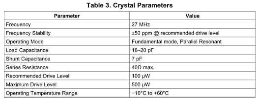

Hi Team,
Please let me ask you about the recommended crystal parameter.
I believe that below parameter is the specification for the crystal itself.
When implementing to the crystal oscillator circuit (matching), there will be difference in the total frequency tolerance or stability.
What is the target value  for the crystal oscillator parameter which must be followed ?
Our customer will use a crystal which has frequency stability of +/- 30ppm for -10C to +85C.
However, after matching in the circuit (optimization), frequency stability became -98ppm and drive level was 120uW.
Would you have any problem using in this condition ?

    In general, the crystal parameters are dependent on the particular crystal from your supplier.
    There is some adjustment you should do to bring the crystal frequency to the center (ie 0ppm). Adjustment of the load capacitor will help.
    I will ask the AE of the LMH0346 to follow up on this case.
    TK Chin
  • Hi Kawai-San,
    Our data sheet recommendation was based on a particular Crystal from a Company called Abracon. We have worked with and recommend a crystal from another company called KDS Daishinku. Based on KDS recommendations we should use 15pF loading Cap for their crystal and this meets their drive level(260uW max). The KDS crystal part number is: KDS’s P/N: 1B427000ZZ0A
    Based on testing we did with KDS this resulted in 93ppm frequency tolerance and we did not observe a problem. I suggest if your customer contacts KDS to inquire about this crystal and their recommended settings.

    Our customer had been talking with KDS, had a recommended setting result of several frequency tolerance depending on the load capacitance of the crystal.
    I have asked customer to use the crystal with the higher load capacitance which  has better frequency tolerance characteristic, recommended lower value than your test data 93ppm.
