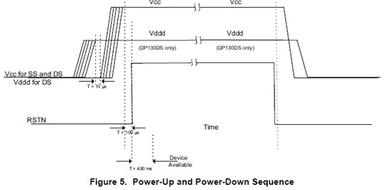

Customer has some concerns regarding power up / down sequencing.
 Figure 5 (below) of the data sheet indicates VCC must  be delayed by 10us or more, reset is deasserted >100us after VCC valid.  Power down side looks like, reset, then VCC, then Vddd.  Evaluation hardware (DP130DSEVM) does not appear to have any power sequencing or  much in the way of a reset circuit (simple cap)
Question(s) –
Is the reset before power down a requirement?
Is the VCC before Vddd power down sequence a requirement?
