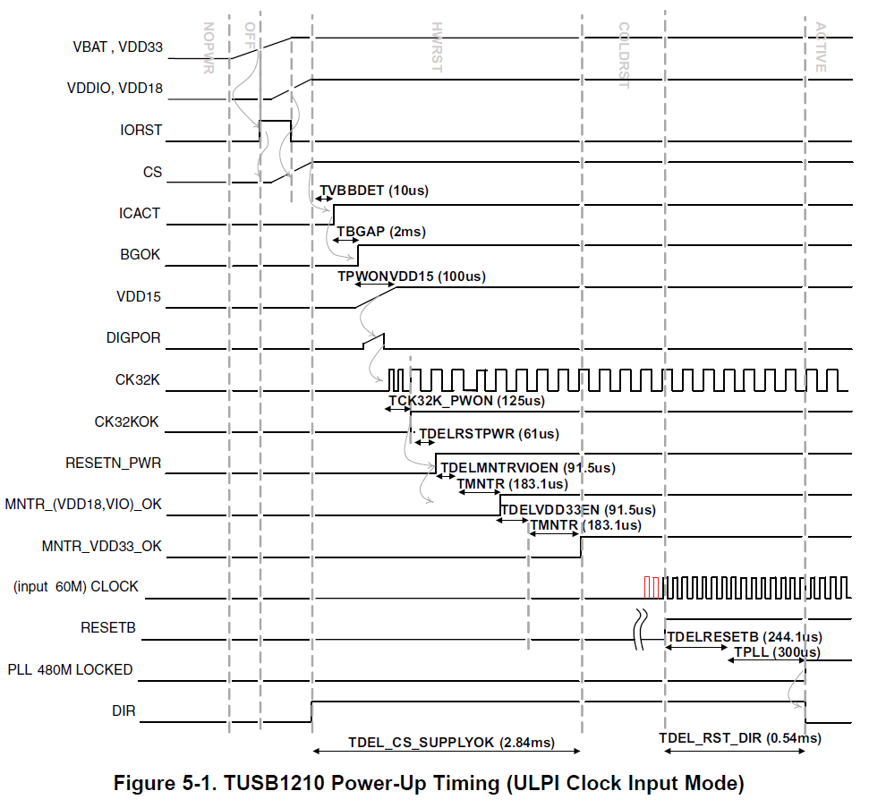

Can TUSB1210 input CLOCK before RESETB in figure 5-1?
I attach an illustration of image.

Hello Katsunaga-san,
It is possible to have the input clock first, it wont damage the device. However, this may cause an undesirable behavior of the PHY. Therefore, the customer must follow the power-up sequence from the figure 5-1, in order to avoid any issue.
Diego.

Does (input 60M) CLOCK of the figure 5-1 mean the same time in a timing of RESETB ?

It means that the input clock must be stable when RESETB goes to high.
Diego.

I understand it.
