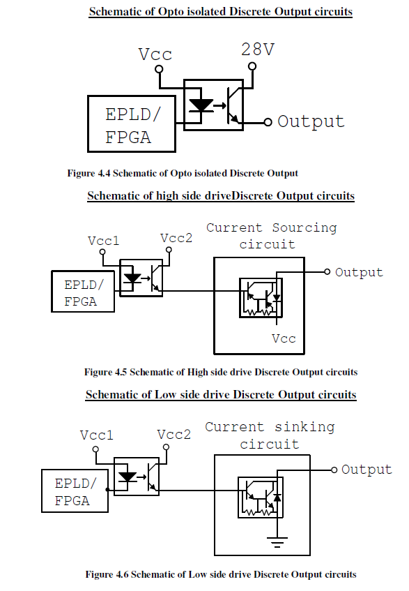

Hi Support,
I have to generate the 28V/GND logic from 3.3V/GND signal. Can you please suggest the circuit with part number. I also need to have current source and sink options possible on these outputs with optical isolation.

Abdul,
How many bits of data and what is the maximum bit rate?
Are the 28V and 3.3V grounds the same or isolated?
Hi Ron Michallick,
It is very slow speed status signals which may run till 1Mbps max. I have shown the type of outputs that I want to implement in below images. Total 3 kind of outputs
1. Discrete output (200mA) - 8 No's
2. High side drive output (Current source - 200mA)- 16 No's
3. Low side drive output (Current sink type - 200mA)) - 24 No's
