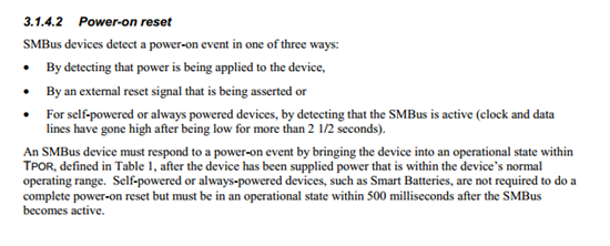

Our customer is using DS80PCI800 in SMBus master mode.
Tpor-max described in the data sheet is 500ms.
However,I think the PCIe device has to start up within 100ms.
In SMBus master mode, Do we have to secure 500ms after power on?
