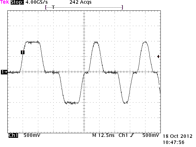

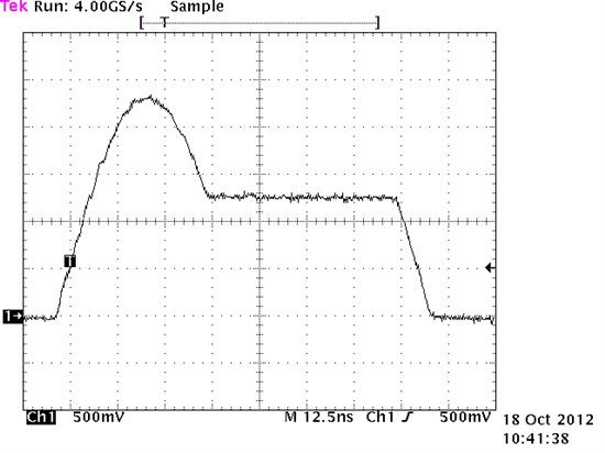

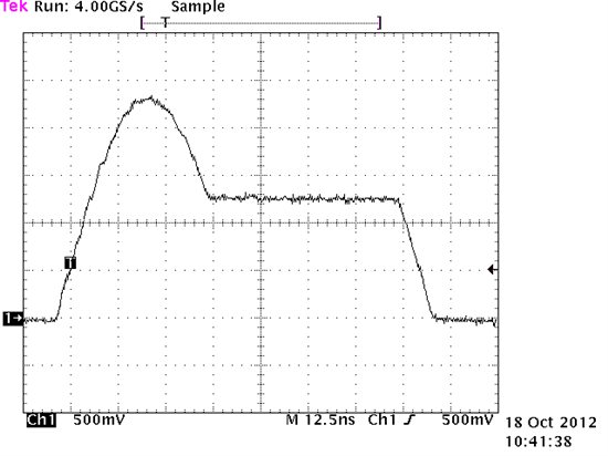

  • Parvateesam,
    For reference, I have included below some oscilloscope shots of the expected signaling when probing the transmit signals with the 100 Ohm terminated cable.  When the device is configured for Auto-Negotiation, it will transmit link pulses.  When the device is configured for 100M, it will transmit scrambled idles.
    Patrick
    Link Pulse:
    Scrambled Idles:
