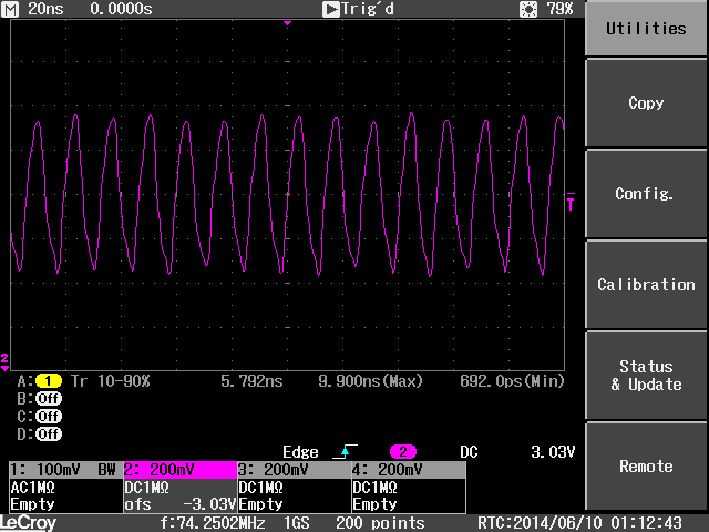

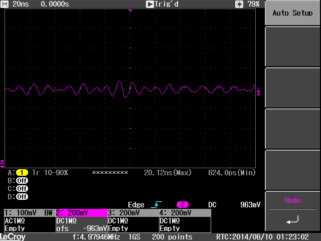

We have a customer using the TPD12S520RMNR.  They say that when they connected their device to an HDMI source it would not work.  After they removed the TPD12S520RMNR it started working, Then they noticed that when the TVS is in the circuit it attenuates the signal level by around 70%.  Please see the attached image files with scope plots and schematic.  Can you help us determine what is causing this problem please?

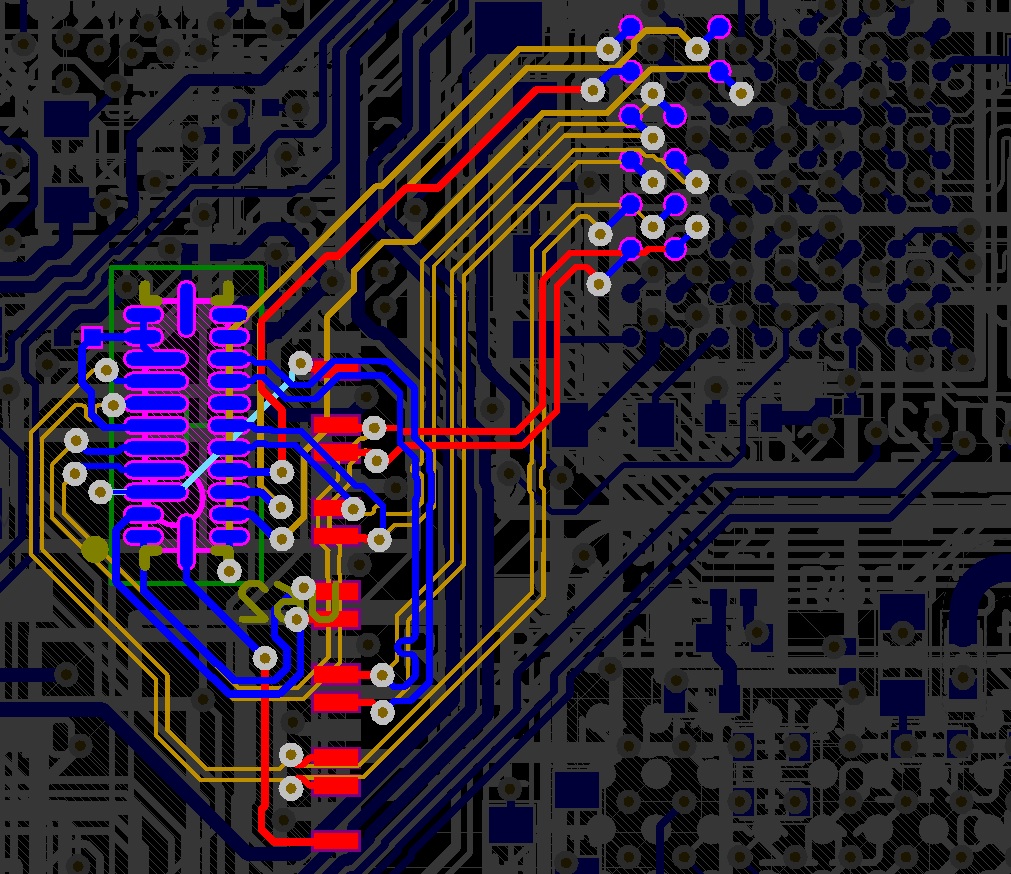

    Now that the customer has their system running they need to go back to the smaller package for production.  They did a screen shot of the layout and it is attached here.  Would you take a look and let me know if you see any problems.
    Thanks for your help.
  • John,
    The problems I see are the stubs to TPD12S520RMN (TVS) from the protected lines being too long. This minimizes the protection by the TVS because the current is not being forced to the i/o pin of the TVS. This will also severely degrade the signal integrity (SI) as these stubs are longer than λ/10, thereby being either capacitive, inductive, a short, an open, or some mixture of those. By my calculations, for 2.4 GHz in FR-4 λ/10 = 5.7 mm. One of the stubs is 10 mm long. These will definitely degrade the SI, as well as provide little ESD protection.

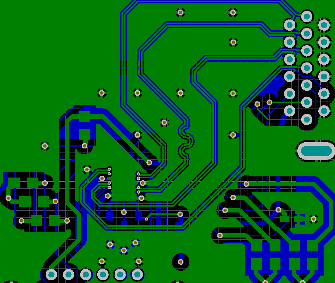

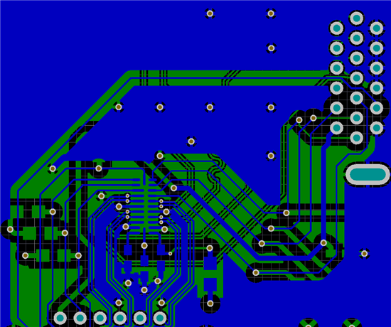

    Top (blue) and Bottom (green) Layers (showing Top Layer on top):
    Top (blue) and Bottom (green) Layers (Showing Bottom Layer on top):
    The connector in the upper right represents the HDMI transmitter. I hope the customer can implement these changes into this design as the one you have shown has some problems.
