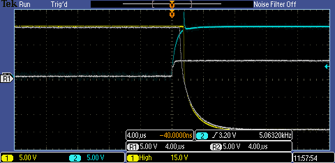

  • The ISO5500 fails such the input power supply is shorted (crashes the 5V supply) and the output goes to 0V instead of low (-15V).
    It appears the little re internal is very very small, I measured the peak current with 12 Ohms and the peak current is 2.49A. The desat slope I refer to is the controlled output voltage during turn off for a short circuit load (VCEsat).
    I made a low pass filter (100 Ohm source resistor + 4.7nF to ground from pin5 and the ISO5500 is very much more stable (didn't fail under test). The problem I have with this is the phase change from input to output.

  • Yes C22 is increased to 4n7, this appears to have eliminated the failure due to noise on the optic input. Pin1 and pin5 are joined so the filter effects both inputs.
    Pin2 F2 is connected to a low impedance ground plane, have not considered noise here as all high current switching is reasonably separated. Ref Attached.
    For our application R7 is a pullup to a CMOS logic gate so needs +15V. I see the pin is open Drain so I am hoping it is good for this voltage.
    With the input filtering I have around 1uSec delay for turn OFF and 1.2uSec for turn ON. According to the spec on the device I am driving this should be acceptable. It would be nice to now improve the switch OFF time which now is slowed by C5/R10.
    Thanks Steve

    Ah yes, the 2 is actually the pin number of Q10. I have considered putting a filter here, only I was trying to keep this as low impedance as possible. I have tried a Resistor/Diode combo to balance the ON/OFF delays and this does appear to be ok. C5 needs to be 22nF to compensate for the lack of Gate capacitance seen by the Desat discharge circuit, resulting from the emitter follower used in the output drive amplifier. The 22nF gives me around 2uSec turn off time at the output (turning off several thousand amps of short circuit current so di/dt is important).
