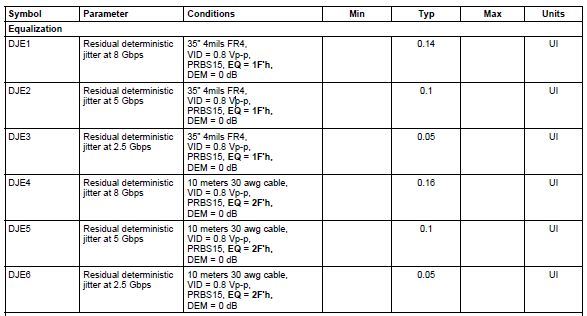

What is the value of jitter in this model?

    4. Residual deterministic jitter will be modeled in this device when the equalization is applied during the simulation. It is not modeled with separate jitter parameters. Therefore, there is no fixed value for jitter in the model, as it will be a function of the channel and the applied equalization.

    Please let me ask some questions about your reply for Q4.
    Residual deterministic jitter is defined in the data sheet.
    So, does the IBIS-AMI model include the value of residual deterministic jitter?

  • Hi Kato-san,
    Yes, practically speaking it does. Residual deterministic jitter, in the context it is presented in the datasheet, is nothing more than ISI which has not been compensated for by the equalizer. This can come about as a result of under-equalization or over-equalization, and therefore it is captured by the model.
