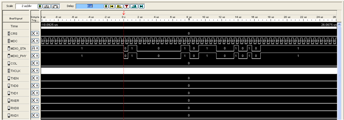

I also used a logic analyzer to record the MDIO signal. There is one significant difference between the signal of the usually used PHY and the TLK 106. The PHY Adress and the Register Adress are identical but the Register Data differs in two bits.
What information do these two bits contain?
Usually used PHY:
TLK 106:
Do we need to do any software changes?
Is there any possibility to get the TLK 106 to work with our device?

  • In RMII mode, the 50MHz reference clock must be provided to both the PHY and the MAC.  How is the clock provided to the MAC?

  • Hi Daniel,
    Can you please approve the 50MHz oscillator at U5 is shared to the MAC?
    Can you take a scope picture of the Clock provided to the MAC, somewhere near the MAC clock in?
    The CUSEVM user guide states on page 4:
    "Note: In RMII mode, the PHY shares a 50MHz clock with the MAC. Install a 50MHz OSC on the
    TLK105/6CUSEVM at U5, and remove the crystal. The MAC receives the shared CLK on the TX_CLK pin
    on the MII Connector (this pin is not used when working in RMII)."
    Noam
