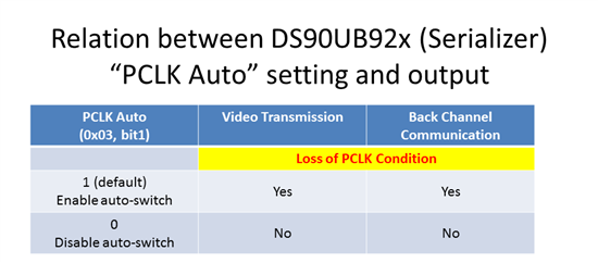

<DS90UB925, "PCLK Auto" setting and output status>:
I would like to make sure how device behave under loss of PCLK condition.
When "PCLK Auto" is set to 1(default), device still can maintain its video transmission and back channel communication, correcct?
On the other hand, if "PCLK Auto" is set to 0, no communication can be achieved.
Here I summarized in the table.

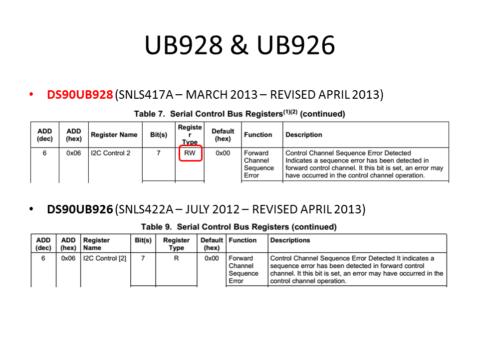

<DS90UB928, Forward Channel Sequence Error bit>:
Can you check whether register type of "Forward Channel Sequence Error" bit is correct?
If it's same as UB926, this should be "R".

    1) Your table is close. On the 925, if PCLK auto is set to 1 and PCLK is lost, then there will only be back channel communication. This means back channel in both forward and backward directions, but not video transmission. You can still access registers remotely via I2C when PCLK is lost. If PCLK auto is set to 0, lock will be lost and communication severed when PCLK is lost.
    2) The forward channel sequence error bit is indeed Read-Only, as on the 926. The datasheet has an error.
