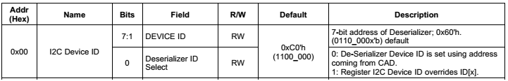

<0x00[0], I2C Device ID/Deserializer ID Select>:
It says that "0: De-Serializer Device ID is set using address coming from CAD". What does this "CAD" stand for?

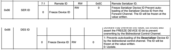

<0x06[0], SER ID/Freeze Device ID>:
There is no details for 914, which 913 has. Is this same as 913?

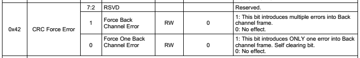

<0x42[1:0], CRC Force Error/Force Back Channel Error>:
These are used to test serializer can detect some errors which put on back channel communication intentionally.
    I am not sure what CAD stands for but if this is set to 0 the device ID is loaded from the resister divider on the IDx pins.  See Figure 37 and Table 10 for more details on the 914A IDx pins.  If this bit is set to 1 the device id can be programmed by I2C to reg 0x00 bits [7:1].
    If bit [0] is 0 then [7:1] will be auto loaded from the Serializer ID through the forward channel.  Setting bit [0] to 1 will allow you to write the I2C address to bits [7:1] and keeps it from being overridden by auto loading.
    Setting either one of these should cause errors to appear in the paired 913A reg 0x2A when in BIST mode.  This is often used as a sanity check to make sure the device is truly in BIST mode.
