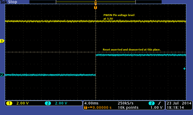

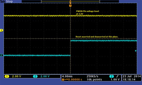

The issue is i am able to access MDIO registers through MDIO bus but RMII interface is not working, using oscilloscope i found out that even TX_EN pin is not high which should be high to enable transmission.
Kindly help.
