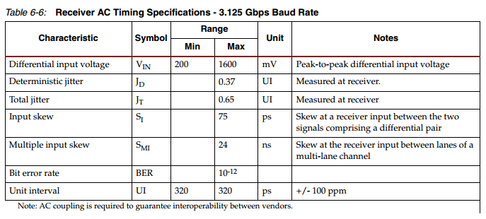

    Alternatively, a better selection than the DS25BR100 is the DS32EV100.
    Looking at the Aurora 8b/10b spec, I see the following requirements at 3.125 Gbps:
    TX Spec:
    RX Spec:
    This differential input voltage requirement looks more suitable for CML instead of LVDS, due to the characteristic of the expected TX output differential voltage as well as the need for AC coupling in an 8B/10B environment. Therefore, a comparable equalizer to the DS25BR100, but made suitable for this application, is the DS32EV100, an equalizer that provides up to 14 dB of gain at 3.125 Gbps and also uses CML inputs/outputs. See specs below:
